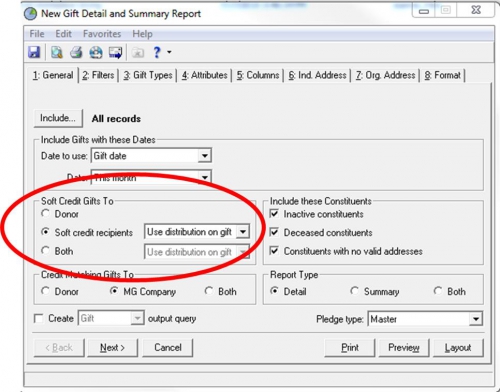

Totally agree with what everyone said (great explination Tom!)
Not sure if anyone addressed your comment about how hard creditting the org can screw up reports.
Depending on the report you can select to include soft credit donors (usually there is a portion that has text something like "Soft credit gifts to" and you can pick donor or soft credit recients or both - to exclude the org from the report select Soft credit recipient under that area and Use distribution on gift)
See photo below for what to look for/do:
Oh and we deal with a lot of soft credits here and I totally dispise them!0
