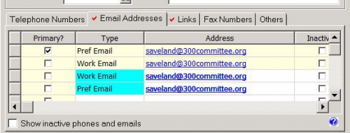

So here's what I'm getting in my query results (sorry the picture is teeny and I can't seem to make it bigger):- So there are 4 lines for 9304-0 with repeats of the Pref Email and Work Email.
- This is the situation where the relationship has 2 emails coming from the constituent record and 2 'repeats' on the relationship.
But I don't see any distinguishing information on those 4 lines that would allow me to distinguish between the 2 phones on the individual record and the 2 phones on the relationship?

What is the bulk of your data cleanup? Would you want to do it manually or automate it? In either case, I believe the instructions I gave would still work. You'd definitely want to test it with just a couple rows to make sure it works as intended though.So in the example above, how would I know which 2 of the 4 phones to mark for removal?
Sorry, but I'm not entirely sure, as I don't have an example of this in our system. You could try exporting out every field available for phones and see if there's any way to figure it out. Also, if you try to import over the "yellow" numbers, it may error out on you, and only let you import over the "blue" ones. Take a test record and play with it to see if you can figure it out.0
That's what the last screenshot was showing, I exported out the relationship phones and there's nothing to distinguish the 'yellow' ones from the 'blue' ones -- nothing that I could find. So there's no what to actually know which phone I'm looking at. Very weird .... maybe Blackbaud will chime in0
Can you get at anything useful via Export? I'm wondering if the Import ID or System Record ID might be able to shed some light. Compare these IDs to the parallel IDs on the constituent's record. Can you find a match? Discern a pattern?0
Nope -- all I see are the 4 phones attached to the relationship and the phone IDs and the phone type - so how do I distinguish the two Pref Emails and the two Work Emails? No way to tell them apart ...0
If you look at the Relationship record and make the column "Source Record" visible, you can tell which phones come from the Organization's Constituent record. Unfortunately, this isn't a queryable or exportable field.
