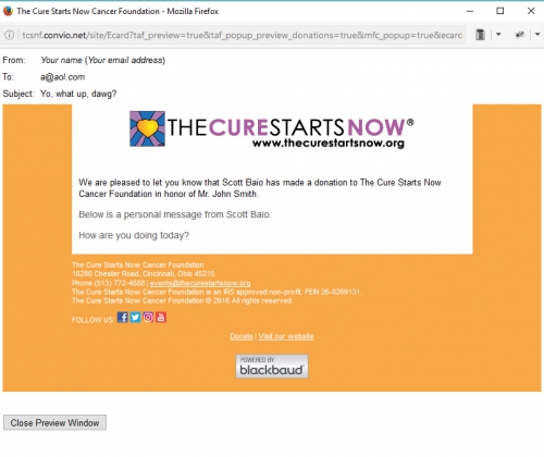

Hey there, Sarah
To make this happen you will want to make sure you are using the eCard preview on the live version of the donation form to see the to, from and subject field populated. Please do not use the "Test Drive" option for testing that piece out.
Here is an example of it working for me, personally, with a client's donation form below:
You can also build an email stationary dedicated to the purpose of a Donation eCard and make sure you have [[S120:dc:donorFirstName]] [[S120:dc:donorLastName]] and [[S120:dc:honoreeFullName]] in a message before the [[S63:1]] (insert message content S-Tag is the S63:1 S-Tag). To ensure that the donor's name is populated, please make sure you have the Donor First Name and Donor Last Name data elements added to your donation form above the preview button so that it can pull that information into the preview. Please be sure to relabel those fields if you want the name to display differently than Donor First Name and Donor Last Name to the donor on the form itself.
