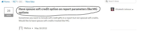

Here are some ideas in Ideabank on this issue - sorry can't figure out how to give you a direct link so you'll have to search by title:
--> Have spouse soft credit option on report parameters like MG options (26 votes)
--> FIX spouse soft credits!!! (69 votes)1 -
First, for anyone who doesn't yet know how to create a hyperlink in a Community post or comment, see Holly's Helpful Hint from 03 Nov 2016.
Second, to eliminate the searching (with great thanks to Gina for locating the appropriate Ideas in the first place), here are the links for the RE:7 Idea Bank that Gina posted: Spouse Soft Credit Report Parameters and Fix Spouse Soft Credits.0 -
Jen - Thanks, how did you actually get the link? Or did you cobble it together -- ??0
Gina Gerhard:
Jen - Thanks, how did you actually get the link? Or did you cobble it together -- ??Jen - thanks for the links!
Hi Gina,
We missed you on Wednesday at the regional meeting. Thanks as always for the great handouts.
To get the actual address for the idea I select the idea and then I right click on the name of the idea to copy the link address.
Unless you are following the direct link the URL is normally generic for every idea. I'm sure you noticed that.
