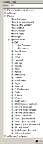

I do much the same as what Sunshine said. But I don't bother with the Requests No Email checkbox. Nor do I use the DNC, Inactive, or Primary functions. I do it all with Phone Types. For me, it's cleaner and easier, because of the way those fields are available (or rather not so useful) in Query. Here are my Phone Types:
We are starting a new, separate, eNewsletter in a few months. My plan is to create a new Phone Type and enter duplicate Phone Numbers. Because if someone has more than one email address, but only signed up for this eNewsletter with one of them, I need a way to do that with as little room for error as possible and as little fuss as possible.0
