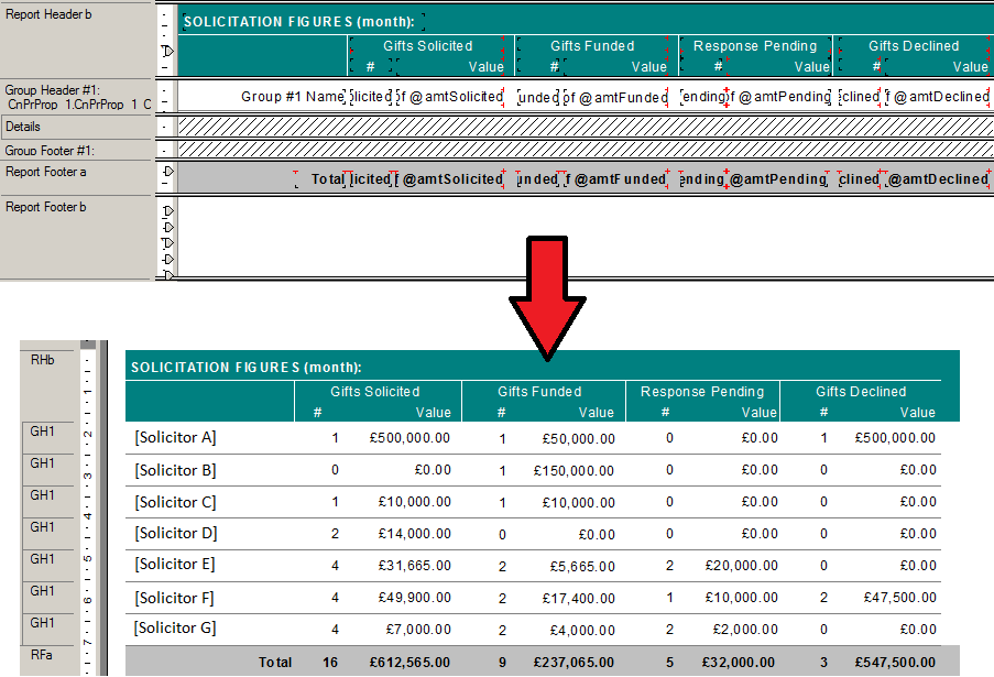

I've created a very similar report - I found that the cross-tab functionality didn't work very well for this, because I wanted to count the same field in different columns depending upon the proposal status. What I ended up doing was suppressing the details section so that none of the individual proposals are displayed, and grouping the report based on solicitor. I then created several formulas that would be equal to the amount asked if the status was pending, for example, but would return 0 for any other status (repeat for each of the other statuses you want to summarise in the table), and then I created summaries based on those formulas and dropped the summary fields into the group header so that they were also split by solicitor. I've attached a screenshot of both the design mode and preview.
There's probably a less clunky way of doing it, as I'm a self-taught Crystal user, but it does the job.4 -
It takes some finesse to figure out how to do this but it is doable. As Alan said, suppress details and only show the footers with summaries and you are likely close to being there.

Melissa,
What Alan suggested earlier sounds a bit
daunting, but it really isn’t that bad. In a former life (not
RE), we had many reports that would list production requirements
for the next 8 weeks out, with each week in a separate column.In the details area (This does not have to be
fancy and formatted in any way since it will be suppressed.) create
a separate formula for each status. (if status = “Pending”
then value else 0) These formulas will calculate the
value for that one detail record only. Then create a summary
for each formula. This summary will add the values for each
of the statuses. These summaries can be both a Group
(Solicitor) summary and a grand total summary if you like.
These are the ones that have to be all formatted and pretty.It all sounds bad, but is really quite simple
once you have done your first one.Chester
