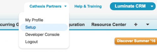

To find a list of Workflows in Salesforce:- Go to Setup:

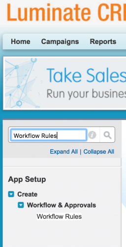

- In the Quickfind box on the left, search Workflow Rules and click the Workflow Rules link below Workflow & Approvals
- If you see a page titled Understanding Workflow Rules, click the Continue button at the bottom of the page.
- On the next page you will see a listing of all your Workflow Rules. Take a look at those that have Opportuntiy listed in the Object column of the list.
0 - Go to Setup:
