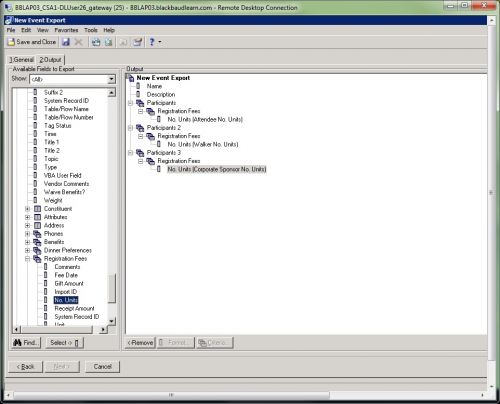

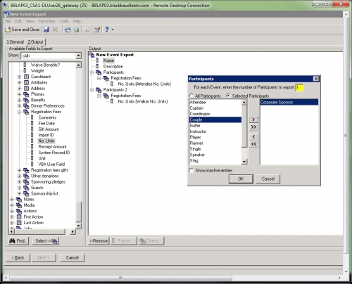

I created an Event Export. I would recommend limiting the results to Include One Record and choose the event you are working on. Find Registration Fees under the Participant section in your available fields list and choose "No. Units." This is basically summarizing the number of tickets or bags you sold for this event. When the criteria window opens, enter 1 for the number to export, select only 1 of your ticket options, for example men's bag, and say OK.
Repeat the steps above for each type of ticket/bag you have. Make sure that you are creating a new criteria group/section for each of your ticket/bag types, as shown below.

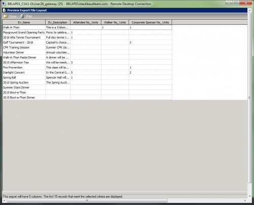

When you preview the Export, you will have one column with the total number of tickets/bags for each of your ticket/bag types. Your preview should only have one row listing the specific event that you selected. Save this parameter file and run it as fequently as you need to in order to track your ticket/bag numbers.

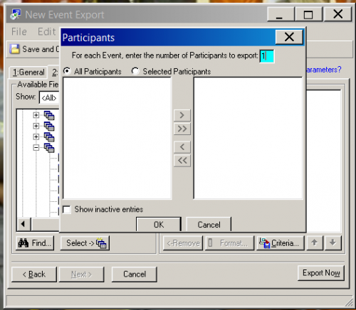

I tried duplicating your Event Export, but when I get to the Registration Fees level of the criteria, my options do not show up. I have fed some dummy data in with a couple different types of Registrations as discussed below, but I am not given the option to select.Hi, Terry!
Looks like it's been a year since your last response was posted

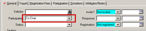

Don't give up! You were on the right path. The "Participants" selection window shows the various choices within the "Participation" field, on a participant's record:
It looks like you don't have any "Participations" in your RE - so all you need to do is leave "All Participants" checked, and press "OK" to continue with the rest of the export.

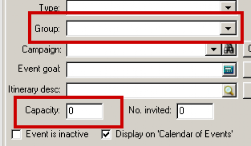

I do have an alternate suggestion, if you want to limit the number of registrations. My suggestion is to use 2 events - one for men's bags, one for women's.
Then, you can use the "Capacity" field to set a limit for each event. Please see caveats* below, for more info on capacity.
I also recommend creating a new "Group", called "Christmas Gift Bags 2017", and setting it for both events. There are several reasons for this:
1) When you open a participant, you see all of the events in that group that the participant is registered for. Thus , you would see who's getting both men's and women's bags.
2) There's a "Grouped Event Registration" wizard
3) Some events allow reporting on Event Groups, so you wouldn't need to run 2 separate reports.
*Capacity caveats:On an event record the Capacity field allows you to set the maximum number of total participants that can be added for an event. Any individual or organization added to the Participant's tab will count toward the maximum capacity number that was entered on the Event's General Tab and includes registrants, guests or sponsors.
In The Raiser's Edge, when the business rules are configured to Warn when event capacity will be exceeded, The Raiser's Edge will warn about exceeding event capacity when the sum of Registered, Not Registered, and Do not Registerparticipants equals or exceeds the event Capacity set on the General tab.
The NetCommunity Event Registration Form and Event Registration Form (Classic) part types only count participants marked as Registered toward the event capacity when set to use event capacity. This creates situations where The Raiser's Edge produces warnings about exceeding event capacity when manually entering new participant records, while the NetCommunity Event Registration Form parts continue to allow online event registrations.
Solution:
Reduce the Capacity on the RE Event record to the number of Registration = Registered Participants that should not be exceeded
