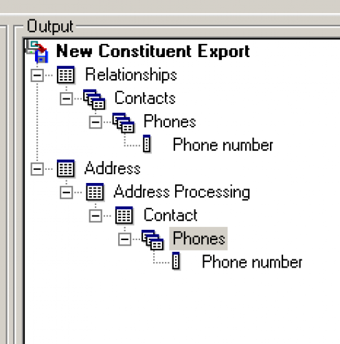

How about if you use a Query (based on your existing query so that there are no repeating rows), with logic like this...
(Constituent, Address Processing, Phones, Do Not Contact? = NO
AND Constituent, Address Processing, Phones, Phone Type = Email 1, etc.)
(OR Relationship, Contact, Address, Phones, Do Not Contact? = NO
AND Relationship, Contact, Address, Phones, Phone Type = Email 1, etc.)
Then export the corresponding email addresses?0 -

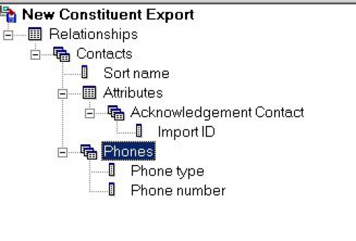

Eleonore Heinrichs:
Thanks for your responses Jen & Sandy. Yes, those are options, but they do not allow us to limit the results based on Contact Attributes. As I noted, we use these Attributes a lot to help identify exactly to which Org contacts we want to reach out. I thought about using the Contact Type: i.e. instead of "Event Contact" change to "Event Contact - Interest A", "Event Contact - Interest B", etc. But this does limit the contact to one interest...with the attributes I can have multiple interests. Alas, my 'dummy data' strategy seems to be working...but it sure is an ugly workaround.In addition to what Jen shows above, you could also export the Contact/Attribute and then choose the attribute you're trying to get.
This will export out the import ID for those contacts with the attribute, and you can then sort your Excel sheet to choose only those contacts?
