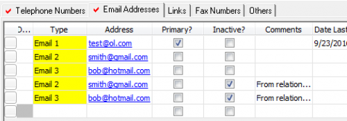

Hmm, I still think that's going to toss out people that I might want... Here's what 7.95 essentially did to our phones:
So if I try to remove anyone with an inactive email, it will remove this constituent. But I don't want that because this person ALSO has active email addresses. Worse, they're of the same email type because they're copied from the relationship records.
We've resigned ourselves to basically looking at the 10,000+ constituents with an inactive email address and then changing the Inactive Phone Type to something like "Bad Email 1" and "Bad Email 2".... Then we can simply query on people who have Email 1, Email 2 or Email 3, knowing that those types are always "active"....

Thomas -
I ended up removing any phone/email that came over with 'From relationship...' in the comment field.- That way I didn't end up with duplicate inactive entries that might conflict with actual active phone/email data.
- I wanted to keep this data as clean as possible so decided to remove anything that I did not see as a value-add or might possibly create some questions.
