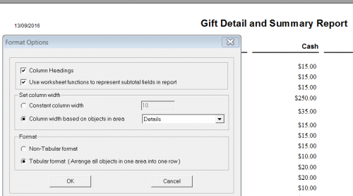

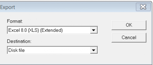

Paula, When you go into the export functions for the financial report what options do you see? When I choose the below options, I do not get any blank rows.
Brenda - I think you are a genius!!!! This worked perfectly - THANK YOU!
