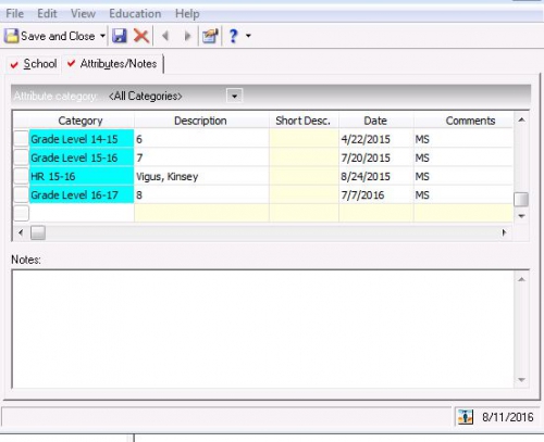

We set up Education Attributes for Grade Level and Homeroom Teacher for each academic year and import them into RE. My attributes look like this on a student's primary alumni educaton record.
I import the Grade Level in late July and the Homerooms in early August, once school is actually started.
The comments field is their "division" since we have several schools in our system that we like to be able to track, analyze - but no field is availabe in the educaton record. In the above example, this student is in the Middle School (MS). We have 5 locations/schools we use and track those in the comments line for the current year attribute.
We mark our school as the primary alumni eductaon for all current students (and alumni, too), and track class of, status, date entered/left thru integration/sync.
I created a procedure document with some detailed instruction, and would be happy to share.

I've been debating using Attributes to store education information as well, mostly because it will allow filters in reports and exports to be segmented so easily. This option is super appealing. Gina, I think both our schools have a similar structure with different divisions. I am debating putting the Division as a drop-down in the Description and the Year in the Comments field. Did you ever do testing on a different set up of your data in attributes.
I am also extremely hestitant to move forward storing this info in attributes because it feels inherantly wrong when there is an Education section in RE. I would be curious to know if there a reason why your organization started some Education info outside of the Education Relationship record area!
Andrea,
We did at one time have an attribute "Grade Level" with the description as the grade level and year in comments. I made the change to keep a separate attribute for each year a few years ago - although I can't exactly remember why at the moment. I think it had something to do with pulling the data into some reports that made it easier to pull straight from the attribute rather than comments. But, honestly, I can't remember. We did make the change intentionally, though. I do remember that!
What feels inherantly wrong to me is importing this data that is EE driven, but not synced. I know it would be rare, but what if the student switches grades, campus or homeroome teacher during the middle of the school year. I usually watch this data through early October (when our Development department works on division/homeroom giving contests) - and then just let it be the rest of the year.
Which brings me to your question - why did we start storing the info. Our development department began running (and therefore tracking and reporting on) division, grade level and homeroom giving with contests with pizza parties, etc. to the division, grade level and homeroom winners. Therefore, we needed to be able to track this through the eductaion information as it related to the PARENT's or GRANDPARENT's records. So the queires would filter by the relationship education STATUS (current student) and relationship education attributtes grade level, homeroom and division. I set up a word merge through export for the development department to run for tracking this info.
