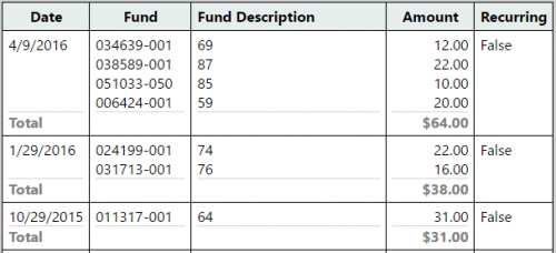

This project uses the RE API and C# and I am working on displaying the Donor's giving history but am having trouble getting the Fund Descriptions for their gifts.
As you can see by the picture below I am loading the EGiftSplitFields.GIFTSPLIT_fld_Fund into the Fund column and I am temporarily putting the EGiftSplitFields.GIFTSPLIT_fld_Fund_RECORDID into the Fund Description column since I cannot find an option within EGiftSplitFields that gives me the Fund Description.
How would I use the Fund or Fund_RECORDID to get the Fund Description?
Below is the code with a highlighted row where I am temporarily putting the FundRECORDID into the Fund Description column.
