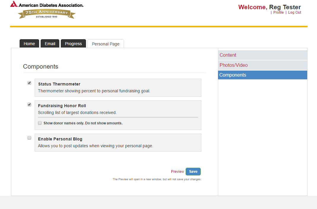

Check the following potential candidates:
Teamraiser > Edit > #3. Select Event Options > Related Actions > Edit Advanced Options >
#9,#10, #11, #18 have checkboxes that ask whether you want the teamraiser to display the amount
Also within the Participant Center, there is also user controlled default generated options under
Personal Page Tab > Components (provided if you set that to be changeable by end user from the backend Teamraiser (again that Advanced Option)
the second checkbox says "Fundraising Honor Roll" checkbox "Show donor names only. Do not show amoutns" -- this setting would probably be applicable to default OOB scroll not the custom one (hence that's normally I leave the scrolling component default so that one could benefit from these preferences)
