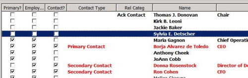

- In addtion, we 'hijacked' one of the fields on the front relationship screen and named it 'Rel Categ'.
- In this field, we also choose 'Ack Contact'.
- This gets around the downside of not being able to see the attribute easily on the contact record -- this way, you can see it on the first screen as well as on the grid (if you add it as a visible column).
- So in this view, we can see both the Contact Types we've set up and who is the Ack Contact (in the Rel Categ column).

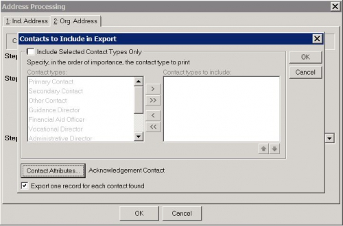

- In the address processing area, there's an Org address tab and on that window there's an option to select 'Contact Types to Include' or 'Contact Information'.
- Note: There's also a Contact Address Attribute button but this is NOT what you want -- we want the contact attribute NOT the contact address attribute.
- Note: The constituent you need to pull MUST be checked as a Contact -- but they don't necessarily need a Contact Type selected.
- In the 'Contacts to Include in Export' window, there's another button 'Contact Attributes'.
- In the 'Include' section, this is where you want to define the attribute so you'll be pulling the right contact.
- When you hit OK and come back to the prior window, there's then a checkbox 'Export one record for each contact found'.
- If you check this, it will export out a line for each contact with the attribute you've specified. That way you should be able to produce multiple lines for each contact defined.
- Here's what the Contacts to Receive Mail window looks like (in Export)
- Note: You do NOT have to specify the Contact Types (in the Include Selected Contact Types only) but you DO want to specify the Contact Attributes and make your selection for Printing one for each contact found.
This can be a tad confusing but if you do it a few times, and work with some data where you know what you want for results, it does work well.

Yes, I see what you mean -- if you have a lot of complexity around where the gift resides and many different people involved I can see why you want it permanently associated with the gift record.
For us, I do know we end up shifting this contact acknowledgment code around quite a bit amongst contacts at the organization. And if in the same gift acknowledgement cycle we had multiple gifts from the same organization but they had to go to different contacts, then this would become an issue. I suspect if this has ever happened they just manually adjust the letters ...
Is it possible that it would be better to split the Org record into a unique record for each branch? I guess what I am thinking is, that the thank-you letter would be directed at whatever tier approved the gift. If an Org is centrally organized, so that donation requests must be sent to a central office, then you would send the thank-you letter to the central office. But if the org is composed of numerous independent franchises, each directing its own donations, perhaps it is better to simply enter them as individual constituents?
For example, we have two local hospitals that recently merged. Even though they are now one corp, and donations from both branches are issued from the same financial office, each hospital still maintains its own public relations rep who approves donations for its own branch. So, we have left these hospitals in as two separate Constituent records. Similarly, we have two different grocery store franchises of the same company, and for one fraternity organization we probably have 50 different Constituent records in our database, because each one has its own contact, its own mailing address, and acts independently in issuing its own donations.0 -
Faith - Well let's just open up a big can of worms here!!
This is an issue I'm sure most of us struggle with in our systems - internally I call it our 'complex organization' issue. When you have an institution that has many branches/departments/subsidiaries - and at some level they needed to treated separately but on another level they need to be treated consolidated. We have this issue most often with universities and departments within the universities.
Basically we set them up as separate organization records -- trying in the name to make some connection if possible -- or in the first line of the address. And then we'll create an org relationship between this sub-record and the main organization record - if there is one. In some cases, we have to create a fake 'master' record that basically just serves to hold relationships to all the related records - in itself it doesn't have any other data on it - and it's clearly named 'Organization A MASTER RECORD'. But that way you can make relationships between each subrecord to this master record (instead of trying to relate all the subrecords to each other).
Not sure if RE NXT has any better approach to this - in some ways it's like the 'household' problem, but for organizations.2 -

Does anyone on here pull gift acknowledgements for instutitions from the gift record directly - by clicking the Microsoft Word button next to the letter type and using the Export fuctionality for the letter specified?
My team members would like to run their one-off acknowledgement letters this way and not through Mail, but we are having an issue with getting more than one letter to pull. The system appears to choose a contact at random (within the restrictions of the Contact Types specified in the export) and generate just one letter, instead of generating a letter for each contact on the organizations record.
Is anyone else able to get this process to work for orgs with more than one contact?
(To further preface: I know how to set up a donor acknowledgement letter in Mail. This is not the solution I am looking for...)0 -
On the reference next to the gift, I'll put the contact name so that the thank you letter goes to the right contact.0
Set up Gift Attribute Fields for the info that needs to be in the letter for the Contact Person. Contact Salutation, Contact, Addressee, the Org Name and Address is already merge fields, so it's just those two gift attributes. And they can be put in the letter as merge fields, they are on the list of merge fields for RE Mail.
Soft crediting is muddy and like you said, RE Mail does not dig deep enough to get that info.0
