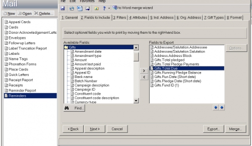

The Mail module. There is Pledge Reminders you can format them however you want utilizing Word Wizard. We have always had the top look like the beginning of a letter (so one to a page), with a reminder of what they have committed to and how much, and then the bottom third is what looks like a return coupon with their name, address, amount due and fund and due by date. A return envelope is included when sent.Thanks Christine! This is pretty much what I've designed our reminders to look like. One question on the merge into Word. Were you able to find an amount due merge field? I wasn't able to find anything that would pull from the pledge payment schedule within RE.
In Mail as DIane posted, but to pull that field on Tab 1 you need to use Reminder Type: Create Custom Data File. Using that option actually gives access to a lot more fields for personalization/details.1
