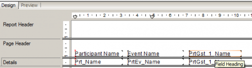

  • If you create a participant query with the required criteria, plus "Participant Guest of blank", this will exclude anyone who is a guest of another participant. That should allow you to create a participant export containing only non-guests. In the export, expand the Guest section (second from bottom, between Sponsoring Pledges and Sponsorship List) and add the guests' names etc.
    When you use this export as a data source in Crystal, all your non-guests will be in the "Prt" table, and your guest information will be in "PrtGst_1"
    In Crystal, add your participant and guest fields all together in the details section:

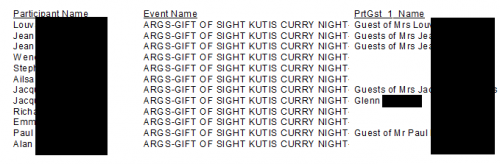

    which then looks like this with the data:
    add4f1528ae7d05f53c4a4b52f6d054f-huge-cr
    It does cause duplicate rows where the participant has more than one guest (lines 2 & 3, and 7 & 8 above), but I think there's a way around that by using an array formula to concatenate the guest names into one long string. I've used something similar for attributes before - I'll see if I can dig it out if you'd prefer not to have duplicates.
  • Something I forgot to mention in my previous post: the Prt and PrtGst_1 tables will need to have a join type of Left Outer Join. If you leave it as the default Inner Join, you'll end up with only the participants who have guests.
