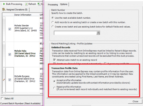

Hi Michael,
Are you using the bulk processing option? If you are, you may be missing one step. After clicking the bulk processing button, the processing box pops up, go to the options tab and scroll to the bottom and make sure you check the "Reject Profile Information" button to ensure that it doesn't replace the donor information with the good information that is living in RE. If you want to see everything in action, we have a live webinar around this topic (Downloading Transactions in OLX). Sign up here! It's included with Online Express.
Also...be careful not to do what I do (Every. Single. Time.) and click the [Close] button thinking that it's a [Next] button. This will close the entire window and you'll need to start over, and reselect the Reject option. (Wish this whole process could be set as User Options or Defaults. When I have time, maybe I'll submit this to the OLX Idea Bank...)1
I have useed the Bulk and selected this option and it still overwrites the data. An example. We receive a gift from a very generous donor. She fills out the donation using all lower case on her name and address. I select the reject Information option and send to batch. When I open her record her name and address have been changed to all lower case. It's very agrivating.

So you individually review and mark them on each record, then choose the Reject option, and it still overwrites? That's an issue for a Support Chat, I think.
Michael, are you also unchecking all the user-entered data when linking the record? It'll trash your clean data at that point in the process too.
This is in the idea list at https://community.blackbaud.com/forums/viewtopic/356/26623, please vote it up in hopes that Blackbaud will consider implementing it.2 -
Yes, to recap what others have said, pretty much you must reject the information in TWO places: first, manually re-link the donor records and edit/unselect the erronious new data; then, during Bulk Process, select "Reject Profile Information". I also wish OLX had this as an automated User option. We thought that having our online forms integrated with RE through OLX would save us time entering new donor data, but in fact all those clicks just to reject poorly typed addresses for every single online gift takes just as long or longer as our previous system.3
That completely solves the problem. I did not know that I could approve and reject individual lines. Awesome! Thank you!1
