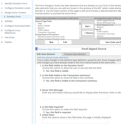

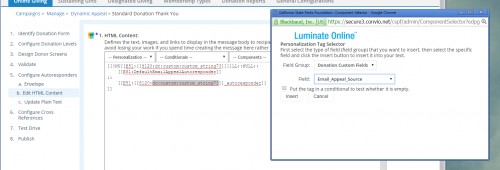

I first created a campaign for email appeals, with a shell form for use with the donation API. In addition to the standard required fields, I created a new data element called Email Appeal Source. This will be populated with the source code and retrieved from the transaction summary in order to render the autoresponders correctly. This is because session variables cannot be passed through to the autoresponders directly. Be sure to hide this field from the user and the transaction summary (the S120:dc tag can still see it!).

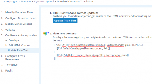

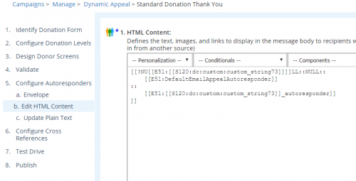

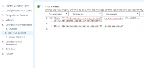

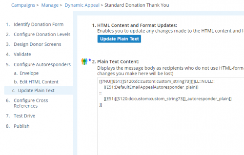

The S-Tag structure in the autoresponders will make sure that email content exists for the given source code before embedding it, or fall back on the default copy if either the content wasn't created, or a constituent somehow arrives on the form without the required s_src parameter. Content inside the HTML and Plaintext autoresponders should look something like this:
Be sure to replace the "custom_string73" with the correct field name associated with the Email Appeal Source field in your instance. Skipping this part will break your autoresponders! Insert the field from Personalization->Other->Donation Custom Fields, then copy and replace "custom_string73" with your own.

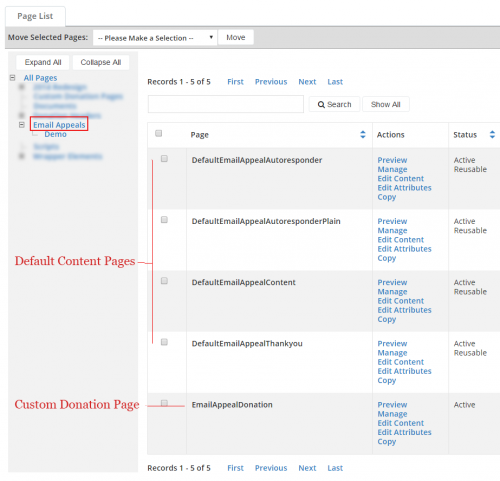

Now that the basic donation form setup is complete, you'll need to create pages where default content lives, and a new PageBuilder page to host your custom donation form. DefaultEmailAppealContent contains the header design/copy that will render above the form, so treat this as though it were an HTML Caption area in the donation page setup. This is a good opportunity to make use of the folder hierarchy if you don't already.
Appeal Content Organization

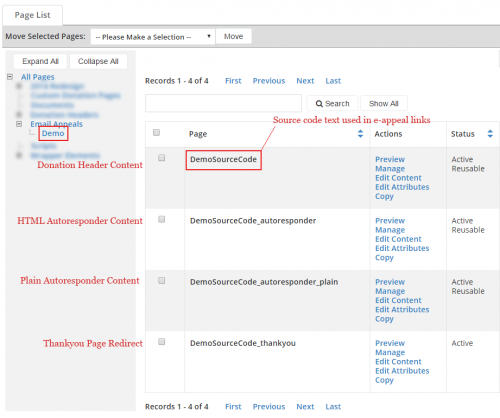

When you create new email appeals, place the required pages in a subfolder to separate assets and keep things tidy. In this example, if I wanted to use s_src=DemoSourceCode as the source code in an email link, I'd create the following files:
These four files can now completely redesign the entire donation experience!

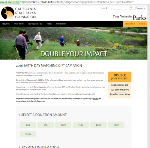

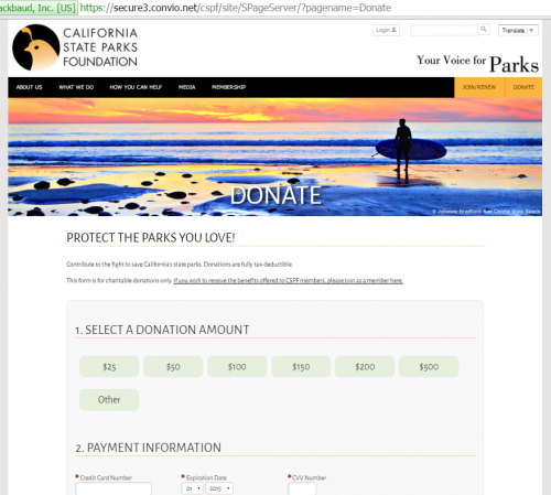

This is our standard donation form as it normally appears:
Same page, with our next e-appeal source code added:
Email appeals can now be rapidly developed simply by creating four small reusable pages that contain the header content, thankyou page, and autoresponder versions. So long as the page names all start with the same source code used in your links, everything renders automatically from start to finish.
