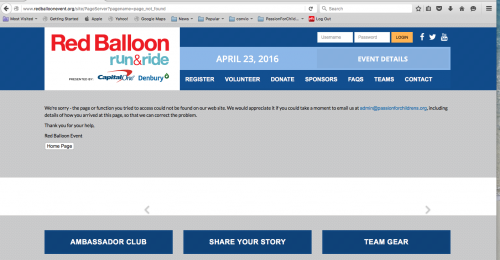

Page not found when Participant logs out from Main Page
How do I direct the system to go back to the home page when participants log out from the main page. When they log out from their participant centers, it goes back to the home page.
