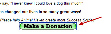

Is there a way to avoid the blue border around hyperlinked photos and graphics?
I've noticed that starting about 4-5 months ago, every image or graphic that I hyperlink gets a blue border around it (see screenshot below). Is there any way to avoid this? It really looks odd and messes up lots of nice photographs and designs.

Hi Brian,
Thank you so much for the help! I just need a little clarification because I am very unfamiliar with coding and don't know how to use CSS. I'd like to choose the last option, which is to never have a border on my images, so where do I need to adjust that code? Can I do that without a CSS code or so I have to manually remove it from the HTML on each page?
