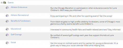

PhilPhilip, any chance you'd be willing to share a sampling of some of the specific interest categories you've set up? Realize they'll be specific for your organization, but seeing a few might help me imagine how to use them in my organization. Thanks!
Hi Greg,
Sure thing!
We thought about how we wanted our org to communicate with our constituents. We are an events driven org, so I will share that breakdown with you.
So high level we have Events
Then below that, we have Athletic-Endurance, Athletic-Recreational, Benefits & Fundraisers, Educational, Golf Outings and Social.
Here is a screencap
Let me know what other questions ya have.
