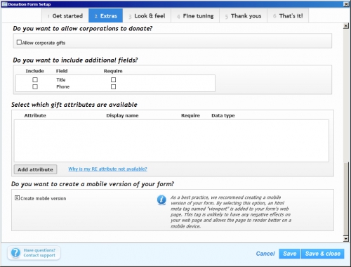

Thanks, Mary. While that is true for the web donation forms, it is not true for the emails. If the email with the link to my form is not mobile compatible, they are unlikely to ever get to the form, as far as I'm concerned. This is a miss.0
I'm sorry--I misunderstood.0
