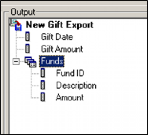

Hi Peter,
I've just tried to replicate this and I don't get the same problem, I only get the 2 lines I was expecting. The way you've described your export with the two splits appearing side-by-side rather than on separate lines suggests that it's to do with the way you're exporting your data - can I ask how you're doing it? (e.g. gift export in MDB format, which is what I used)
This is what the fields in my export looked like:
and this is what it looked like in Crystal (the total gift is £8 split equally between 2 funds; I've included both the split amount and the total gift):0 -
Hi Alan,
Thank so much. I was exporting mutliple fund fields. Just a bone headed mistake I think. Ugh.. Thanks again
