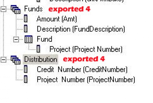

We put in a split stock gift, 3 different funds. For reporting, we need to export each fund's GL distribution, but can only get the first fund's credit number and project number to export, and it exports for all 3 funds details. Any ideas? My ultimate report is a Crystal Report based on a gift export.
What fields are you outputting in the export? Do you have the export field set up to export more than 1 result?0

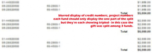

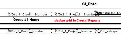

I exported 4 funds, and 4 credit/project numbers per gift. If I only exported 1 credit/project number, the gift showed up with the right fund, but only the top fund's numbers. If I export 4 credit/project numbers, it shows as (in this case there's 3 in the split gift) 3 separate gifts per fund, tripling the amount of the entire gift. It's hard to put into words, so I did a few screen grabs.0

It's really interesting to me that in a gift export, Distribution isn't a subsection of fund.
I just did some experimenting and came up with the same issue you did -- it pulls all of the distributions for each split. So, this post isn't helpful except to confirm that you're not imagining things...

thanks for confirming I wasn't missing anything - I appreciate your time in exploring. I'll have to play with the report some more, and thanks for your tip! I'll have to give it a try.--Jane0
