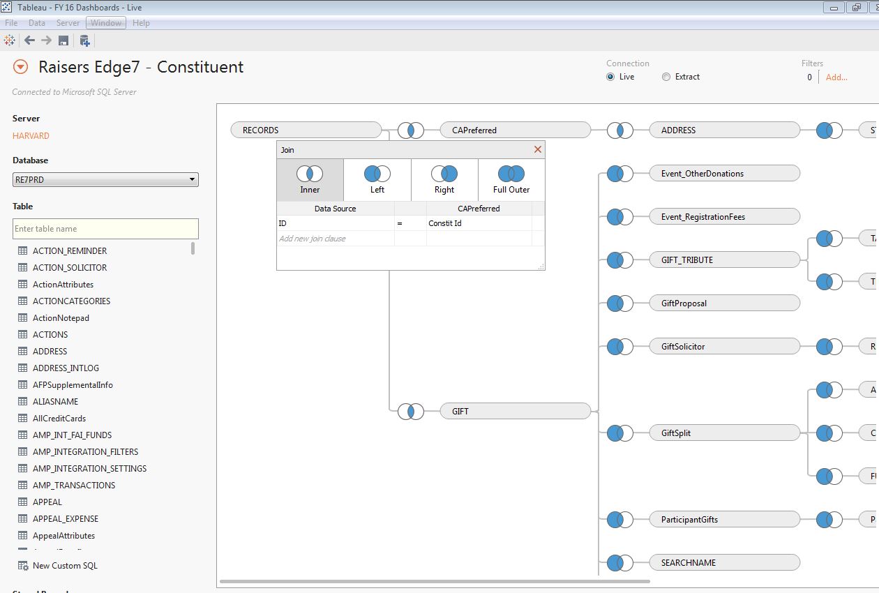

I"m using Tableau connected directly into the RE SQL server. The process of joining tables and describing fields is time consuming at first, but you can easily save the data source (all the table configurations) and start with this for each workbook.
Start by choosing Microsoft SQL Server Connection, select the server hosting your RE database (you may need to contact network admins or IT for access, or location info). Once you're connected, run a sample gift or constituent query in Raisers Edge (I recommend running a gift query) with some key information: constituent ID, gift, gift date, donor name, campaign, and gift type. In the Query toolbar, go to View -->SQL: this is a great cheat sheet to see how relevant tables are joined for these fields. (You will only need to pay attention to the "FROM" section detailing the table connection specifics.)
This might look like:
INNER JOIN DBO.RECORDS AS GIFT_RECORDS ON GIFT.CONSTIT_ID = GIFT_RECORDS.ID
INNER JOIN DBO.CAPREFERRED AS T_1 ON GIFT_RECORDS.ID = T_1.CONSTIT_ID
INNER JOIN DBO.ADDRESS AS T_2 ON T_1.ADDRESS_ID = T_2.ID
LEFT OUTER JOIN DBO.STATES AS T_3 ON T_2.STATE = T_3.SHORTDESCRIPTION
LEFT OUTER JOIN DBO.GIFTSPLIT AS GIFT_GiftSplit ON GIFT.ID = GIFT_GiftSplit.GIFTID
LEFT OUTER JOIN DBO.CAMPAIGN AS T_4 ON GIFT_GiftSplit.CAMPAIGNID = T_4.ID
LEFT OUTER JOIN DBO.FUND AS GIFT_GiftSplit_FUND ON GIFT_GiftSplit.FUNDID = GIFT_GiftSplit_FUND.ID
LEFT OUTER JOIN DBO.APPEAL AS GIFT_GiftSplit_APPEAL ON GIFT_GiftSplit.APPEALID = GIFT_GiftSplit_APPEAL.ID
In Tableau, drag onto the data connection map the tables you want to join, and define the Key/ID used to join each table.
Once you're working in the Tableau worksheet/dashboard environment, you can rename fields and folders so that your dimension and measure titles make sense to you.
Your connection might look something like this:
(I am using Tableau Desktop 9.2)0
