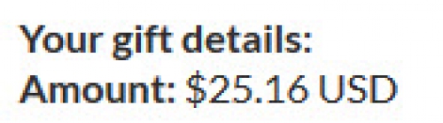

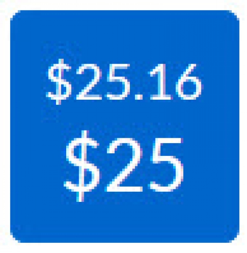

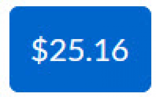

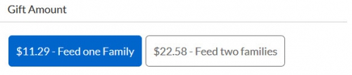

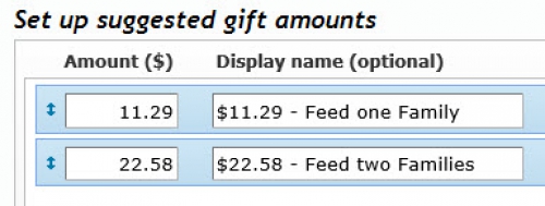

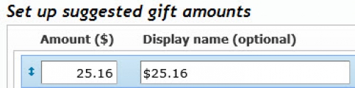

It's actually possible to use fractional amounts for your suggested gift buttons in OLX. But it takes a tiny bit of CSS to make it work (see below). As part of the work we're doing for OLX in RE NXT late this year, we'll be revisiting this. But until then, this should work well:
1. On Step 2 of the OLX donation form editor, add suggested gift amounts to your form in any fractional amount you like....something like $25.16.
2. In the Display Name field, enter the amount you chose for the button (make sure to include the currency symbol):
When you save your form, this will produce buttons that look like this (as noted by others, OLX truncates the fractional amount that's displayed as the button label). Top row is your Display name and the bottom row is the OLX auto-inserted amount label.
3. Now all we need to do is just hide the OLX auto-inserted amount label. To do that, just paste this small bit of CSS either directly above or below your OLX donation form embed code, directly on your page:
<style>
.BBFormRadioAmount {display: none;}
</style>
All it does is hides the amount label that OLX insert onto the button. It will leave the "description" that you typed (which is also the amount, but with the fractional amount included). Your buttons will then look like this:
and when donors click this button and make a gift, OLX will indeed process the fractional amount:
Feel free to post any questions you have here. Thanks!4 -

Sorry Jeanne...I'm not quite following where things are breaking down. If I enter the description as shown below:
then with the CSS I shared, the buttons on my site looks like this:
You can view my live demo site with this currently in-place (as of 2016-03-17) here.
