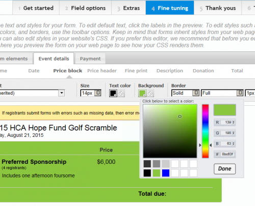

I got around that by changing that particular text to be the exact same color as the background behind it, effectively making it invisible.
You can do that by going to the "Fine tuning" tab, then selecting the "Event details" subtab, and clicking on "Price block." Click on the color box under "Background" to see the exact color of the price block, and if you need to, write down the numerical values of the Red, Green, and Blue, or copy the hex color description (indicated with the # symbol).

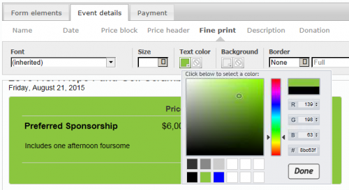

Then click on "Fine print" to select the color of the "(x registrants)" text. Click on the color box under "Text color" and enter or paste the same RGB values or the hex color. And voila! The number of registrants has disappeared!
