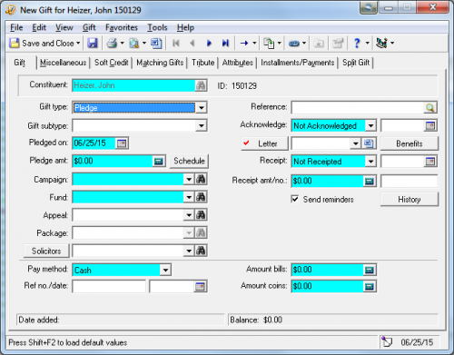

We're using 7.94 (hosted) and I also do not have a Status drop-down on Pledges, only Recurring Gifts.0

I'm baffled. I don't have a Status field on my Pledge records, only on Recurring Gift records. I'm on RE 7.93. Am I missing something? Does it become available if I have an optional module like EFT?

It appears that you need to have the EFT module or the Enterprise version of RE to have access to the status field. We have the Entreprise version 7.93 and have the status field for our pledges.
