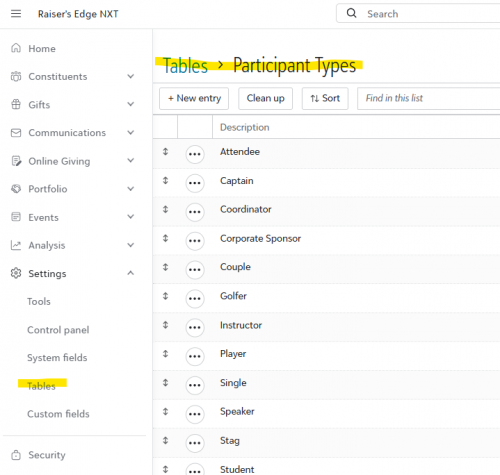

@Clarissa Rice Hampton you could keep date ranges in constituent codes and get outputs based on that and event participation dates. As you mentioned, participant types would be another way to do it. Attached is a screenshot of where you would configure those.
