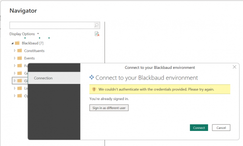

Hi, I built a Power BI connector following one of Alex Wong's video but when under “Get Data” in BI I see the folders but it won't refresh nor open them. It gives me the following error - any clue to fix it? Thanks!

if you got the “Blackbaud” connector, your mez file is in the right place.If you can't authenticate, there are multiple potential:
- did you correctly update the mez file's client id/secret and subscription from developer.blackbaud.com
- is the application on developer.blackbaud.com having the right Scope to read data from RE NXT
- if you updated the Scope of the application, did you go back to the marketplace's connectedc app and approve the scope change
@Alex Wong Thank you, I did have to modify the scope! I also refreshed the client ID, Client secret and subscription key, then deconnected and reconnected the app. I am now getting the following message after login in and authorising the app in BI - can you help? The next message says “Authorization wasn't specified” Thank you.
