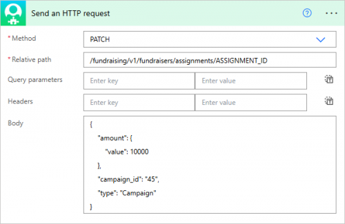

I am at my wits end. I have looked and looked and looked and I can't find a connector with an action in power automate that does fundraiser assignment updates in RENXT. I can create one, and list them, but from what I can see, there is no option to update. Am I overlooking it? I also tried update a constituent relationship, but it didn't work and I suspect that is only for individual/organization relationships.

You are correct - there is no action in the connector for updating a fundraiser assignment (could be that the underlying endpoint in the API wasn't available at the time). This would be a good enhancement to the connector that Blackbaud should consider, so make sure you've logged this in the Idea Bank.
In the meantime, you can use the Send HTTP Request action in the Blackbaud SKY Add-ins connector to call the EditFundraiserAssignment endpoint in the RENXT Fundraising SKY API. Your flow action will look something like this (replace ASSIGNMENT_ID with a token containing the system record ID of the fundraiser assignment you want to update):

@Ben Lambert I just wanted to update you that I got this to work. Thank you so much for your help! It was a great learning opportunity for me to explore using this action! ?
