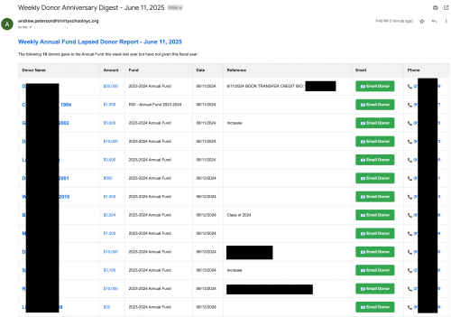

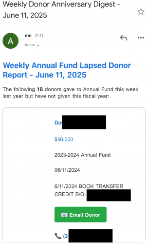

Sample Output
Desktop View:
Email Draft:
Mobile View:
