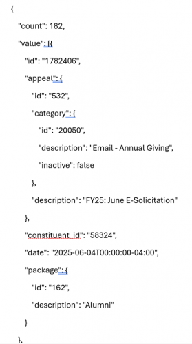

Like Austen mentioned, there is a “list constituent appeals” action in the Constituents area of the API, from there you can get the system record id of the constituent appeal (1782406 in the screenshot below). You can also get the appeal system record id (532) and constituent system record id (58324). When you pull the recent gifts you would probably match on the appeal system record id. Then, I just discovered there is an Edit Constituent Appeal option in the NXT Data Integration API (I was typing this as @Ben Lambert responded) where you could use the constituent appeal id to update the response.

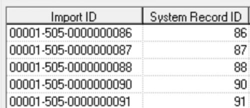

Huge caveat: I have only been doing this using the Try It feature and not directly in Power Automate and as I mentioned above, while “response_description” is part of the Edit Constituent Appeal endpoint, I have not been able to get it to work and I suspect that is because we cannot currently edit that in WV as Austen mentioned.One final note. Austen mentioned not being able to get the appeal import id. While that is true, I have noticed that other than some from our conversion to RE way back in 2003, all of our appeal import ids have the same start and then end with the system record id. This may just be something for our org as we generally are manually adding our appeals so Raiser's Edge assigns the import id and system record id, but wanted to mention it as something to consider for building your own import ids even if they are not accessible via the API.
List constituent appeal response Appeal ImportID and SystemRecordID 1 -
