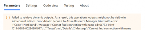

Common Import Errors:
Error: Failed to retrieve dynamic outputs.
- Solution: Create a new connection/connection reference. If a new one is created, make sure to update other actions of the same type, (i.e. all SharePoint actions), to use this connection.
