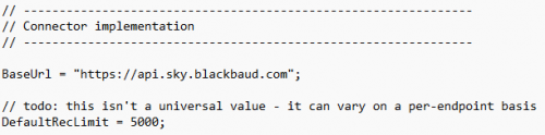

However, I suspect you knew this already and you have done something tricky. We are talking about this open source connector for Power BI, right? GitHub - blackbaud/powerbi-connector: Blackbaud data connectors for Power Query and Power BI
As @Alex Wong is curious about your Power Automate approach, I am curious about how you are applying a limit of 500 in Power BI. Did you edit the custom connector in Visual Studio? The DefaultRecLimit in the Blackbaud.pq file is 5000, and I think the Gift call references the default.
Were you in the Blackbaud.pq script to add a filter parameter for the start date in GiftByList?

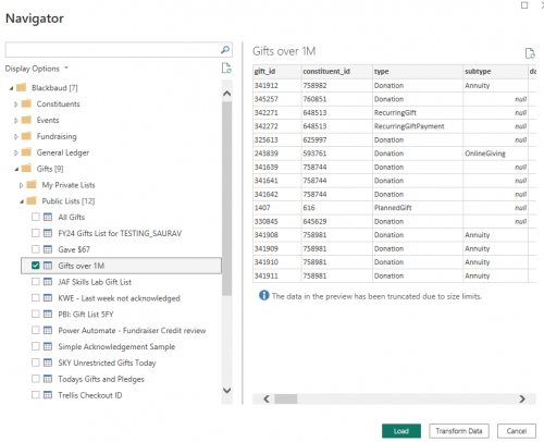

One thing you can try instead is to create a Gift List in the Raiser's Edge NXT and then reference that public list in the Power BI connector.
screen shot of Power BI Connector Navigator in Power BI 0
