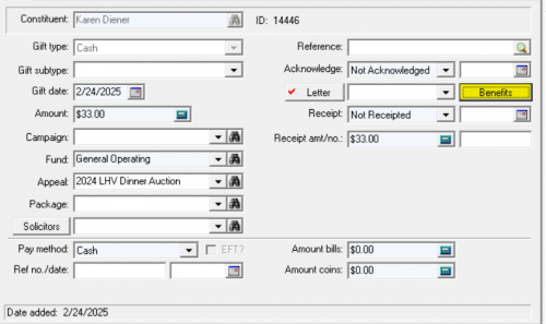

Rhonda Hale you have two fields on a gift record: Gift Amount and Receipt Amount. The Receipt amount is the tax-deductible portion. In letters, you can either report how much is deductible (receipt amount) or do the math and report the fair market value of the goods and services the donor received in exchange for their gift.
Dariel referred to the benefit and said that it is not available in webview yet which is true. On a gift record in database view, there is a “Benefits” button you can use to record the fair market value, i.e., non-charitable. It is a little bit cumbersome to do, and most organizations I have worked with just report the receipt, or charitable amount.(not a real gift, just FYI)
