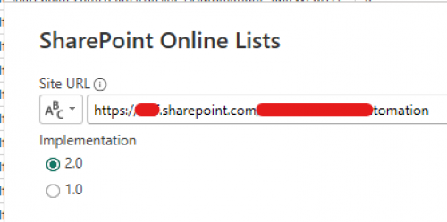

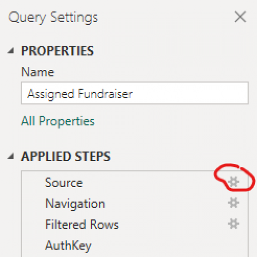

  • Go to Assigned Fundraiser query, and click on the “gear” icon on the Source step
0de85e52d60fa6ffb41e3fb5e068e450-huge-im
3b8989a74ccd50e9372095e9f0f6c7df-huge-im
  • Change the Site URL to the SharePoint URL that you created the SharePoint List for authentication key

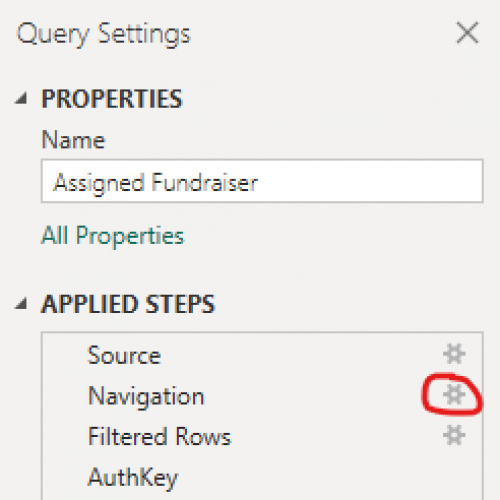

  • Click on the “gear” icon on the Navigation step
8f7b3c991106e1b5f4b5f2f0c44e4337-huge-im
a921c4184ad51aab5a8d25ffdeffb082-huge-im
  • Select the SharePoint List that has the authentication key

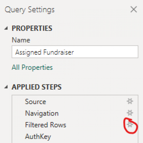

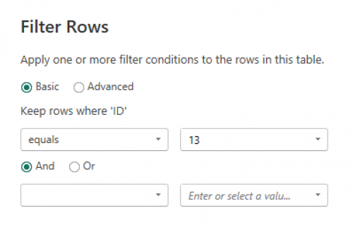

  • Click on the “gear” icon on the Filtered Rows step
d570e46013fd0664139e331cca3211cb-huge-im
d806df5e8b6b0563c79fcbde4843c400-huge-im
  • Filter on the ID equals to the ID number of the record row that has the authenticate key

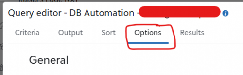

    • Go to RE NXT > Query in webview
    • Open an existing Query that you already did and want the output into Power BI
      • or create a new query, and config all the criteria, output, sort and option

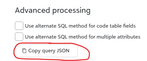

    • go to the Options tab, and click on Copy query JSON button

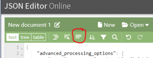

    • Click on the icon that will Compact the JSON into ONE line of text
    70d0b5018db2bdfa3f0107bde04557ea-huge-im
    • Copy the now-compacted Query JSON

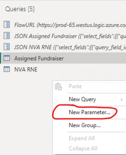

    • Open the Power BI, and enter Power Query

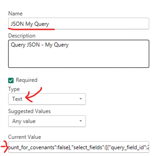

    • On the left panel: Queries, right click on an empty area and select New Parameter…
    e53feafe6b658f3d97d96da20e25b9d7-huge-im
    • Name your parameter (i.e. JSON My Query); Select Text as the Type; Paste the copied Query JSON in the Current Value field; (you can add a Description if you want, but not needed)
    5ef47d2a6f3c61a5c2003707fd65a0e4-huge-im

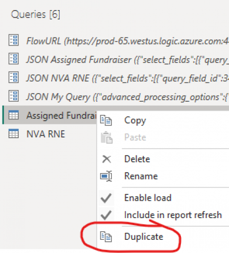

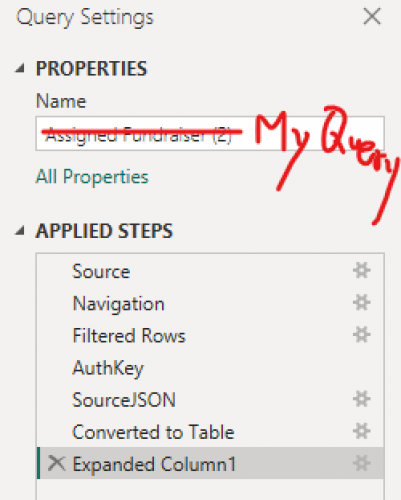

    • Right-click on Assigned Fundraiser (or an existing query that is using Power Automate flow to run Query API for data) and select Duplicate
    b9e736c54a990126b5a2d2d0c43cdb29-huge-im
    • Name your query to somethign meaningful for the data table (i.e. My Query)
    84835e155ee79bbd96ec9238b27bfe1d-huge-im

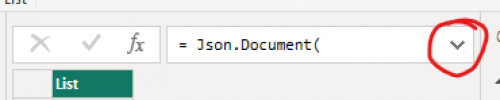

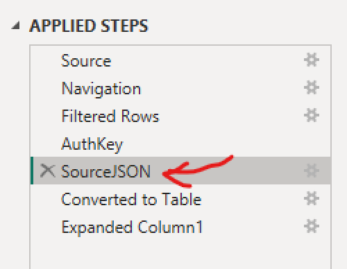

    • Click on SourceJSON step and go to the formula bar and click the down error to expand on it
    fdf1cd7b202cc18952026d8203058e0c-huge-im
    f2868648c25fcb1f6c90aee8597d6b03-huge-im

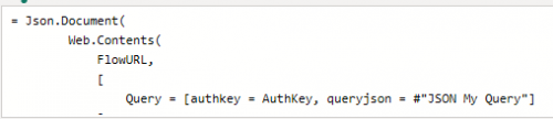

    • Replace where you see #"JSON Assigned Fundraiser" with the name of the parameter you created
    cae2b4df90882cba95681ec2c8c01ec2-huge-im
    d1e34c2cdaf3a5df0895f409cfa4e2d8-huge-im
    • Click Refresh Preview icon at the top menu.

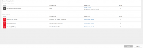

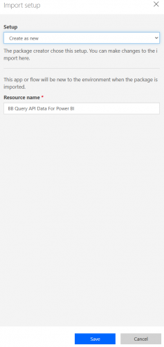

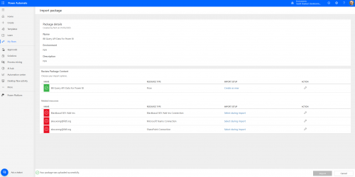

  • @Alex Wong I am attempting to follow your instructions.
    Sadly, I am stumbling at the first hurdle! I don't see any option to “Open the flow” in power Automate.
    I clicked the import legacy flow option. Then I get this screen and there is NO option to “Edit the flow” or similar.
    1236f5342cbfd1cee2a6b58b38a04e2a-huge-sc
    Any suggestions? Thank you!
  • Alex Wong
    Alex Wong Community All-Star
    Ninth Anniversary 1,500 Likes 2500 Comments Name Dropper
    @Scott Davies
    You need to click on the icon in the “ACTION” column and follow through to create the flow, and create the connection needed for the flow.
  • @Alex Wong when I click the action (spanner) column, it gives me the option to create as new, which I do and then click save.
    0c2116b880b71944c6404a20f2e33c30-huge-sc
    996e5f56c4cb3bdf3832cc42d5c0ac76-huge-sc
    However, the import button at the bottom of the page is greyed out. It's obviously missing something.

    @Scott Davies
    there are 3 more rows of Action icon you need to click on.

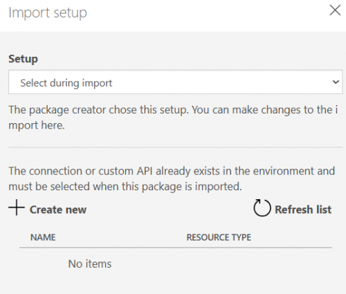

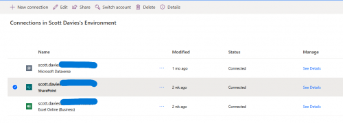

  • @Alex Wong when I click on the action (spanner) icon, I get this:
    feda0893b834f17556181e5bfc431e8b-huge-sc
    Clicking on +Create new opens a new window with these options:
    3c0cf8955957de891c17fe9a9d568079-huge-sc
    I don't see any option to use the connection or add it to the flow. How do I allocate one of these options to the flow?

    @Scott Davies

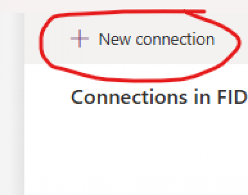

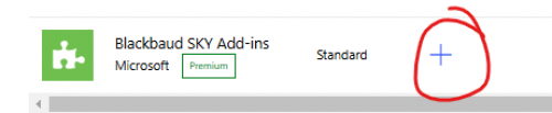

    First order of business, Blackbaud connector are “premium” connectors, so you will need to be using a paid license of power automate (i.e. Power Automate per user license, for non profit, it should be $3 / month).
    If you do have that, then for each “Related resources”, you will need to choose a connection, if a connection already exist, you should be able to just select it (i.e. Microsoft Teams and SharePoint), but for one that you never used before, you will need to click on “+Create new” then on next page, click on the “+ New connector” at the upper left of your 2nd screenshot.
    681ae2ee752570e29c57c1c3d301a18a-huge-im
    then on the next screen, search for name of the connector you trying to create a connection for. “Blackbaud SKY Add-ins”, once found, click on the + on the RIGHT to login to your RE NXT environment.
    47ea83ee8df3bcab697b618577739220-huge-im

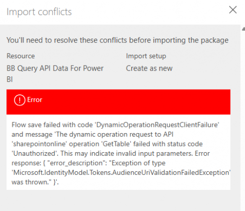

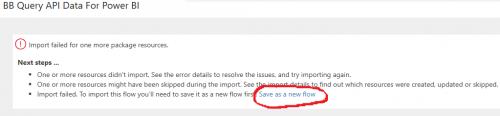

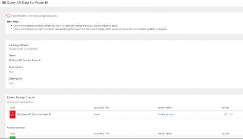

  • @Alex Wong I'm attempting to access this flow and am getting the below error message which I can't get past. Any thoughts on what might be causing this? All the related resources appear to be connecting correctly, they have the green checkmark.
    3601ca8eb2cd9665d191d36f33b8923c-huge-im
    2daaaeb5c2e251ea5083106cd06f8488-huge-im
  • Alex Wong
    @Becky Griswold
    please show the full screen of the import.
    if you setup all the connection, sharepoint will give you an error b/c you can't access my sharepoint list. you will then see near the top, somewhere that will say “Open Flow”. Click on that to update the SharePoint get item as per instruction
  • @Alex Wong Thank you! I was looking for a button or something similar. This morning I was trying again in order to get a full screenshot to post and found the “Save as a new flow” link within the Next Steps section. That seems to have gotten me into the flow to make the needed edits. Hopefully I won't need to bug you again :) I really appreciate your help and expertise.
