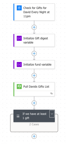

@BrieAnna Clothier - Hi BrieAnna, I thought I would help out a little here. Alex is referring to the List Gifts part of the flow and in your sample below, it would be Pull Davids Gifts List. If you click on that you will see toward the bottom a list of fields like this:
Gift Date Added= Added on or after. Here I am using a Past Time variable that I set up before that says Get Past Time which can be go back 1 Day, 1 Week, 2 Days. Anytime you want to look back to today and then you put it in that field.

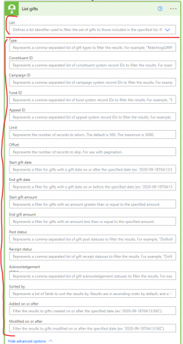

@BrieAnna Clothier keep in mind that List parameter (to select a saved gift list from RE NXT) is mutually exclusive to ALL other parameters on the List gifts action.
It only has Added on or after parameter, so you need to play with that. (so you cannot do I only want gift added From a date To a date.) If you need to do From and To, then you do the From (using Added on or after), THEN use the Filter array action to reduce/remove gifts from the result beyond the To date.
