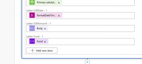

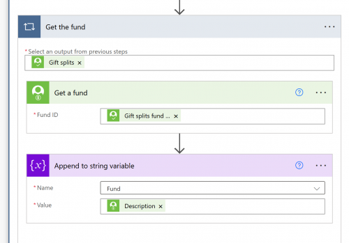

I just tried to add the fund designation to my tax letters. It works fine if there is just one letter in the gift list. If it loops through multiple letters, the word file is concatenating the fund from the previous letters.
inside my apply to each:

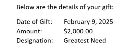

The first letter looks fine:

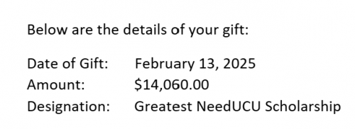

second letter, this one should only list UCU Scholarship and NOT Greatest Need

this is b/c you are appending to a variable.either at the beginning of the apply to each (the one that loop through each gift) or at the end of, you need to do a reset: set variable action on the “Fund” variable and set it to expression of null or string('')
Thanks Alex! That worked!
