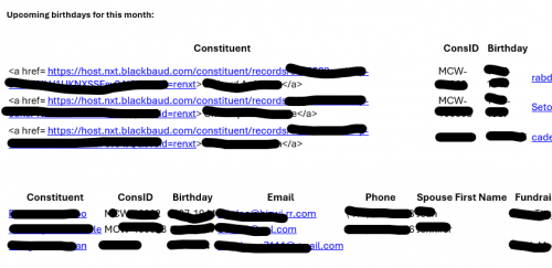

I'm trying to figure out why the Power Automate email I receive has the hyperlink showing the code around the Name field that I want it to show. Any suggestions?

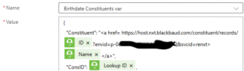

I have this:

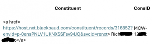

And the output from my email shows:
(I've blocked out our envid and the name fields above.) I don't want to see the code, but I do want the name to be hyperlinked.

https://community.blackbaud.com/forums/viewtopic/586/67455?post_id=265991#p265991look at the last screenshot in my reply, where it tells you the replace() expression to use.
@Alex Wong Thank you. I had forgotten about the Replace for those characters.
When I ran it again, my output email lists everything twice; once as the wrong way (like before), and a second time the correct way.
Where should I be looking to delete the top portion? Thanks.0 -

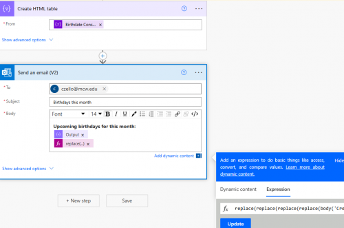

@Chris Zello
show your edit mode of the send email. looks like you added the replace() expression without removing the dynamic content from create html table. so both the table (the “bad” one that you originally have, and the “good” one that is from replace() are both showing)0 -
@Chris Zello
you added the html table twice as i stated in my previous post.get rid of the “Output" dyanmic content that is from the create html table action
@Alex Wong Now that I've removed the “Output” it works perfectly. Thank you again.
