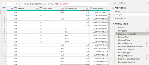

Hey @Veronica Krivis, this is now possible to get from the standard connector, but I just published this update about 3 months ago. So, if the Power BI Connector you set up is older than that, you'd need to download the newest version of the connector from GitHub.
There's now a field on the Gift table titled linked_gifts.1 -
@Veronica Krivis
the linked_gift field will only display for pledge payment, showing the pledge's system record id, which may be good enough for some reporting need. However, it doesn't show on a pledge gift record for which payment (or write off) is paying the pledge.linked_gift also doesn't give enough details for good reporting, as it only tells you the pledge the payment is paying, but doesn't tell you anything else (i.e. doesn't tell you how much of the payment is paying which pledge, if there are more than one pledge being paid for the single payment).
