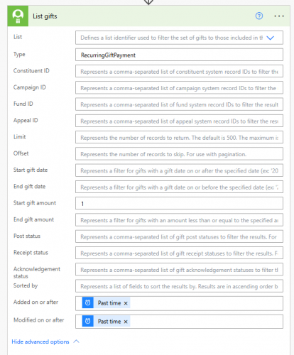

@Susan Fioribello - I would set the trigger instead to be when a gift is added to the system, or if you plan to run this daily - any non-acknowledged RG payments, with a gift date ≥ Jan 1, 2025. This can be set up within a “List gifts” action or an ad hoc query.
@Susan Fioribello- Hi Susan, I thought I would add to what Austen said. I have a flow that sends an acknowledgement out for Recurring payments. Because they can pick their own date I have it run daily and use Past Time minus 1 day. Then put that in the List Gifts part of Date Added or Modified. Also in the List Gifts the Gift Type is limited to Recurring Gift Payment.
Lastly, I put 1 in the start gift amount so that the rejected ones don't get picked up.0 -

I don't think you need to put “Past time” dynamic content in the Modified on or after, just Added on or after is good enough.0 -

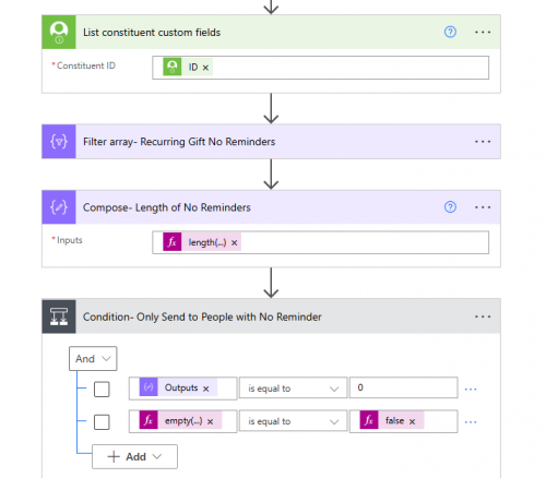

@Susan Fioribello Hi Susan- we have a constituent attribute/custom field where we keep track of whether they want to receive the recurring email. Either way, you can do List Solicit Codes which is located in the Constituents connector. I do Get a Constituent before the List custom fields also.
List, then I do Filter Array based on the code. I did a Compose to get the length of the filtered array then set my Compose to zero. You don't need the Compose step, I think I was testing out the filter array so I added the Compose step. You can do length(Filtered array) in the condition.
I also did a condition that says the preferred email address is not empty.
