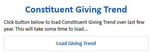

if you want to use Adaptive card, then yes, you can use the multi-card interface. I have a template on this that uses one flow instead of multiple flow: https://community.blackbaud.com/forums/viewtopic/586/69847 (this template can be found in template showcase, search AIAC will find it: All-Inclusive Adaptive Card)So you can have a simple display like:
When the button “Load Giving Trend” is clicked on, then it will call the flow again and do all the “work” that takes time and when done, will display the real stuff.
This is good especially when you know the “loading” takes time. Your staff is using RE NXT daily and opening many constituent records, 90% of the time, they are likely not going to the constituent page to see the giving trend, and if it always load, you are wasting API quota and also performance hit on your flow.

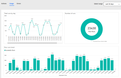

depends on use case and what you intent for the “tile”.Power Automate is perfectly able to handle volume. I have the Constituent tile for Giving Society
Over last 30 days, there are 23,430 runs of the flow. Average out just under 800 per day, no issue at all.

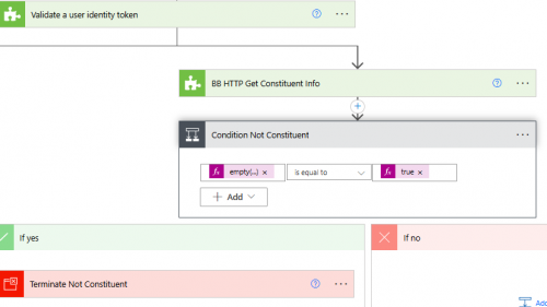

- constituent vs non-constituent.
- not all tile functions will apply to both, usually constituent only.
- at early steps, condition on if the record_id is a constituent or non-constituent record, if not the type to display the tile, you dont' need to return a Adaptive Card JSON and terminate the flow (success termination). This will avoid the tile to even come up on non-constituent spouse, relationship, event participant page
