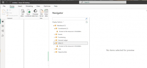

I’m trying to connect my RENXT to PowerBI. I followed the step from this link (https://github.com/blackbaud/powerbi-connector#readme) and everything seemed to go great; however, even though a connection appears to have been made I still can’t see any fields and am getting a message that Access to the resource is forbidden.
I think this is because in the Marketplace, the connector I created has Access listed as None and I can’t figure out how to change it?
Did anyone else have this experience when connecting your NXT to Power BI?
Also, I’m surprised that I’m not seeing a connector by Blackbaud for Power BI in the Marketplace – or would that be included in the Microsoft Power Platform connector?
