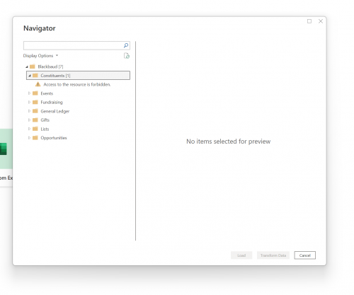

Thank you so much. I deleted it all and redid and it seems to have worked - woo hoo. The only thing is when you do link Microsoft Power BI Desktop with Blackbaud, and you see the lists of things it can connect to on the Consitutents folder it says ‘forbidden access’ is that right?0 -

that's not right. so you have access issue with the API.are you RE environment or solution admin? if not, you have to make sure your application scope covers api that you have access to

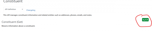

might want to try using the “Try It” tool on developer.blackbaud.com API referenceto see if you have true permission issue or power bi custom connector creation issue.

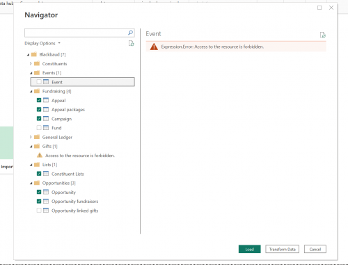

@Alex Wong I've reset this up and getting errors again. I've checked the scope and it's set to full access and i've approved that but this is what I'm seeing when I'm in power BI. Any ideas?
@Pippi Reader, did you resolve your access to Gifts and Constituents so that it is only Events giving you an “access forbidden” error now? Your access permissions within RENXT are honored by the connector too. As Alex suggested earlier for gifts and Constituent end points, you can check your access to Events through the Developer Console with the Try It button: https://developer.sky.blackbaud.com/api#api=event&operation=GetEventList
@Rebecca Sundquist thanks for getting in touch. Yes the issue fixed itself so all sorted now. Thank you!
