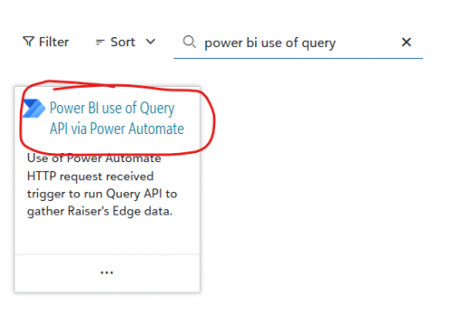

@Alex Wong Adding the recording of your demonstration from the Jan 7 Power BI User group for people to reference as well:
@Erik Leaver
Can you help me make an update to the template showcase link to point to the new/more versatile template?0
