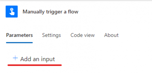

As Alex said, your Parent and Child flows will need to be in the same Solution as a starting point.If you already have a solution with your flows, the easiest way to pass variables to a child flow is to set them up in the child flow's trigger. If you select your trigger and click ‘Add an input’, you can set up as many input as you need.
Once you've done this, when you go back to your Parent flow and select this child flow to run, it will ask you to provide values for all of the inputs you set up.

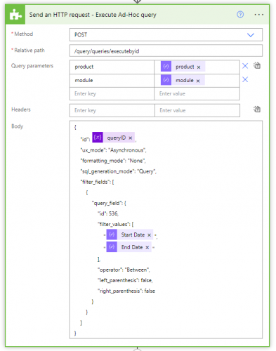

@Ben Regier @Alex Wong I'm successfully getting variables passed to the child! Next issue is a new topic: How does one pass <ASK> dates to the query? Was thinking I'd be able to do so in the Body of the POST request, but it's throwing the following error:
{"type":"urn:blackbaud:ask-field-values-required","title":"One or more validation errors occurred.","status":400,"detail":"Filter field 0 requires corresponding ask values.","trace_id":"b939dfbb199b49f697ead50da0731a11","span_id":"3b08da812de0c793"}

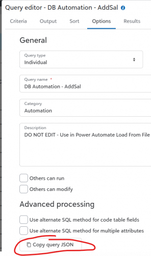

this is one way to do get JSON of query for adhoc querying from saved queryif you have Query in webview (not Query API), you can open the Query in webview and copy the json.. modify it for use too.

Just looked at the documentation for query execution by id and saw this:I guess query by id does support “ask” now, but instead of property “filter_values”, it is “ask_fields”, which is an array.
I would still prefer using adhoc query, but “ask” being supported is good
