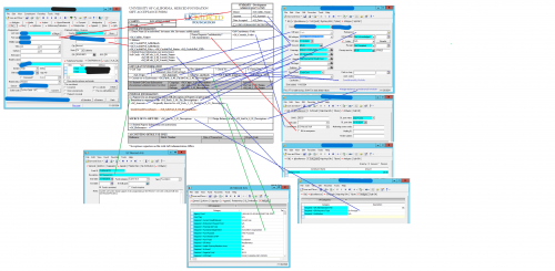

I am new to Power Automate and have only built a few simple flows so far. I've mapped the UDEV data fields to Raiser's Edge, but I’m struggling to build an end-to-end flow that automates this process.
I’m reaching out in the hopes that someone in this amazing community has a similar flow they’d be willing to share or can provide guidance to help me get started. I’ve attached a screenshot of the UDEV for reference.

I apologize I was not more clear in my original post. All of what I am testing is in RE NXT. Not the data base that we have on premise. We have a live version of NXT that I am using for testing that has old data sets. This flow I am trying to build for the UDEV will be done via RE NXT.
I already have the word template created to replace the UDEV. The part I am struggling with is starting the build of the flow. I am lost on how to start the flow itself. Its intimidating when staring at a blank canvas trying to figure out what to start with. This is my first flow I have ever built so I am a PA noob.
