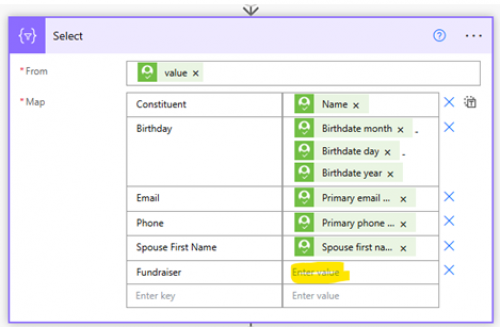

Adding Fundraiser to Map field in a Select
In the BB course for Power Automate, the example shown was how to get a list of everyone with a birthdate in the current month, and create an email.
I think it would be helpful to also see who the assigned Fundraiser is. Currently the email I receive is blank in this column because I'm not seeing this as an option in the Dynamic Content or the Expression options. I'm unsure how to manipulate this so it appears in the email sent.
Is there a way to pull a specific Fundraiser Type in the Select Map?
I'm trying to have it pull in our “Primary Prospect Manager” name.
Thanks.

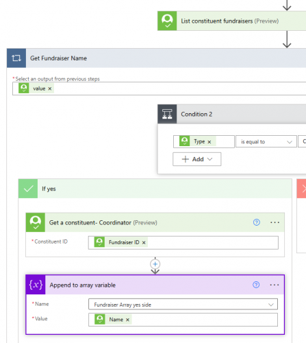

@Chris Zello- Hi Chris- are you pulling the Fundraiser in yet?
You need to do List Constituent Fundraiser, then limit it to the Fundraiser Type you want. Then pull in Get a Constituent for the Fundraiser ID to get the Fundraiser Name.
